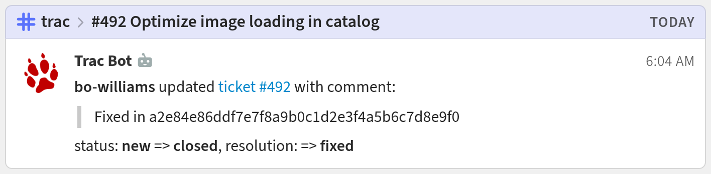

  8. When people open new tickets (or edit existing tickets), notifications will be sent to the stream trac (or whatever you configured above) with a topic that matches the ticket name.
You're done! Your Trac notifications may look like this:
Trac bot message
Additional trac configuration
After using the plugin for a while, you may want to customize which changes to tickets result in a Zulip notification using the TRAC_NOTIFY_FIELDS setting in zulip_trac_config.py.
