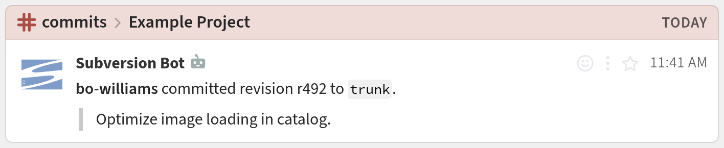

You're done! Your Subversion notifications may look like this:
SVN commit bot message
Configuration options
You can configure the channel and topic where notifications are sent by updating the commit_notice_destination function in /usr/local/share/zulip/integrations/svn/zulip_svn_config.py. By default, notifications are sent to the #commits channel with the repository as the topic name.
