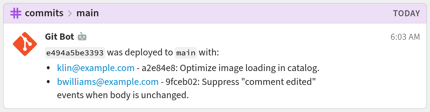

You're done! Your Git notifications may look like this:

In /usr/local/share/zulip/integrations/git/zulip_git_config.py, you can set:
  • The channel where notifications are sent by updating the value of STREAM_NAME. By default, notifications are sent to a channel named "commits".
  • Which branches send notifications when pushed by updating the commit_notice_destination function. By default, pushes to the main, master, and test-post-receive branches will result in notifications.
  • The message format used in your Zulip notifications by updating the format_commit_message function.
