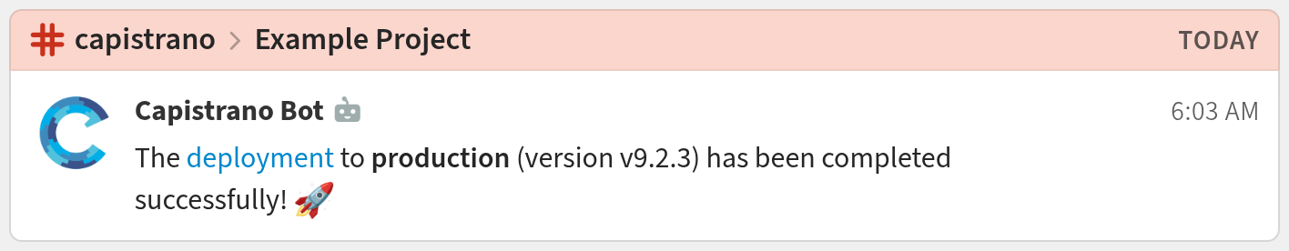

You're done! Your Capistrano notifications may look like this:
